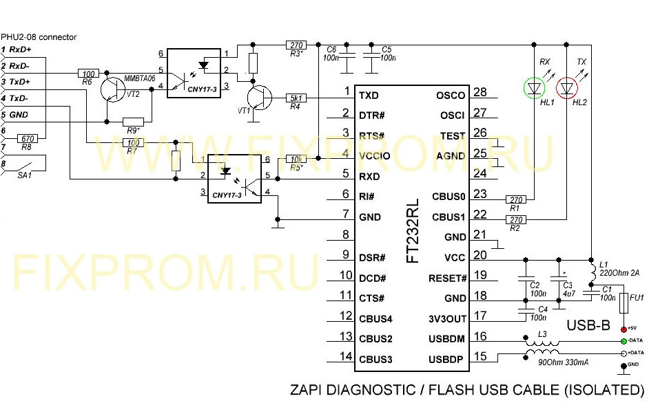

fixprom.ru
8057726 is the interface Zapi RS232-serial for Clark GEX/GTX and PX models. For forklifts with 80-volt Zapi controllers, we use a cable of our own design, which provides full galvanic isolation. Here is its electrical circuit:
